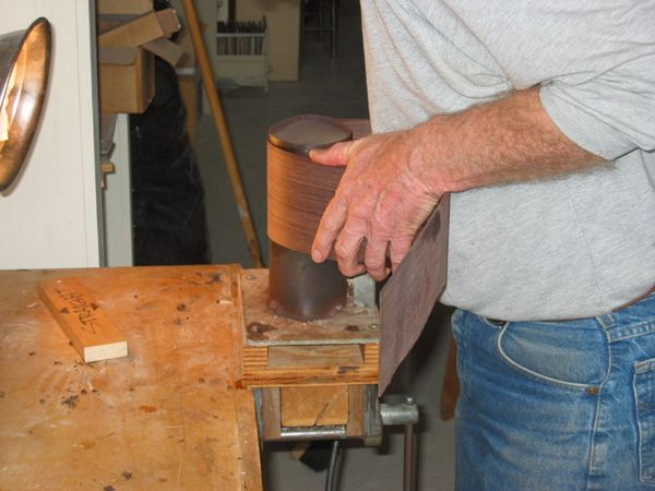

By the way, if you really want to get some practice before you do your bend "for real", get in touch with Bob Cefalu, and ask him to send you some orphan sides that he has pre-thicknessed for you. Bob's great, he usually has those laying around, and they're very reasonably priced. Just a thought.
Also, the photo above is of a well-respected, long time professional builder who has built hundreds of guitars, and has never used a fox-style bender. He's not using gloves, or slats, etc. So before anyone comes along and declares that the process in the photo is unsafe, I wanted to point out that I'm not advocating the above photo as THE WAY to do it...but I've seen it, and done it, exactly that way. YOU do it however you feel safest.
PostPosted: Thu Apr 19, 2007 11:22 am
*I'm not trying to dominate this thread, I promise.
But one other thing: remember to keep the side edge level and parallel to the floor as you bend it. In other words, if you "tilt" your side during the bend, you will have added a bit of twist to your side. "Twist" it too much, and you might get the shape accurate, but it won't lie flat on table surface. When you then go to rough profile the side (or sand the profile into the side in a dish), you run the risk of having to take a lot off the side in order to get the profile...thereby artifically making the side thinner that you wanted it to be. Don't ask me how I know this.
If this is confusing, someone will be along very soon to explain it more clearly than I have. Just remember to bend your side like a guitar side, and not like a Frito. Make sense? Look again at the photo above. See how level he's holding the side? That side has no profile cut into it yet. He's going to add the back profile after the bend is complete.   Hope that helps.
